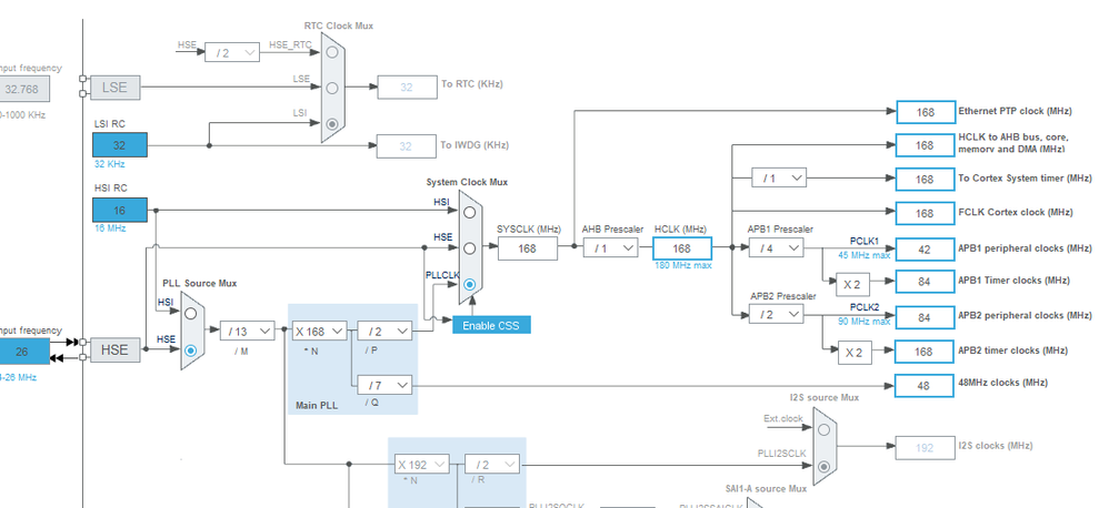

0693W000007Bk2cQAC.pngClock config:

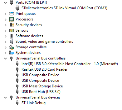

However when look for my board in Windows Device Manager it is nowhere to be found:
0693W000007Bk3LQAS.pngOnly the STLink debugger VCOM is detected and I am running out of options here.

  • Tweaking the clock configuration in cubeMX

Unfortunately Windows still does not see a second Virtual Com Port except for the standard STLink debugger.
I have seen on different forums that people with this particular board have the same troubles I am experiencing (Windows 10 not recognizing the port).
Maybe the problem lies somewhere else?
