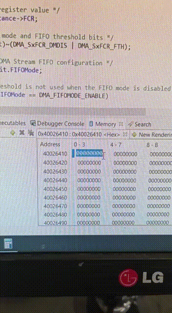

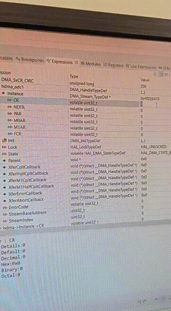

Hi, im trying to write into my DMA2 Stream0 CR register (mapped as 0x40026410).
But that memory addr cannot be written not with my init code nor manually trough the STM32IDE debugging tools .
Is there any memory protection or lock i am missing?

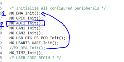

2021-11-04 3:53 AM
Howdy @Bruno_ST
Ding ding ding!, that was it.
Im using autogenerated CUBEMX code.
It looks like CubeMX places ADCDMA config after the DMA clock is enabled (RCC->AHB1ENR), so thats why it wasnt working
If i move the MX_DMA_Init before the ADC init everything works
