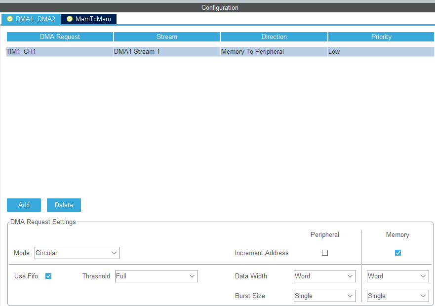

I am trying to use DMA to control GPIO port E output.
Below is configuration of CubeMX
In Cortex-M4 context of dual core , DMA is successfully working to toggle GPIO Port E output .
But In Cortex-M7 context of dual core , although error message, DMA is not working.

uint32_t _gTriOutState[2] = {0x0000FFFF,0xFFFF0000 };
__HAL_TIM_ENABLE_DMA(&htim1, TIM_DMA_CC1);
//__HAL_TIM_ENABLE_DMA(&htim1, TIM_DMA_CC2);
HAL_TIM_Base_Start_IT(&htim1);
HAL_TIM_PWM_Start(&htim1,TIM_CHANNEL_1);
HAL_Delay(15);
if (HAL_DMA_Start(&hdma_tim1_ch1, (uint32_t)&_gTriOutState, (uint32_t)&(GPIOE->BSRR),2) != HAL_OK)
Error_Handler();

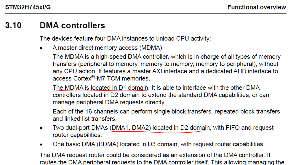

as you suggested, I did it. But it is not working in Cortex-M7 .
is it impossible technically to use DMA1, DMA2 in Cortex-M7?
2021-11-02 1:35 AM
Do I use MDMA instead of DMA1,DMA2?
If i have to use this,Please, let me know how to use it?
STM32H745xI/G datasheet
2021-11-02 1:43 AM
The problem is maybe related two things: memory layout on STM32H7 and internal data cache (D-Cache) of the Cortex-M7 core.
Please have a look at this FAQ: DMA is not working on STM32H7 devices.
