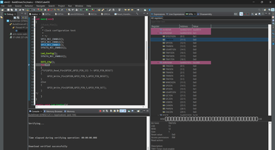

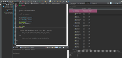

I did write 0x1000. But it is not change. if you look picture you can see what I made

If you look picture. SPI2 and SPI3 is enable but SPI1 isn't still enabled. maybe it has protect? or it is not true hardware
2025-08-22 1:54 AM - edited 2025-08-22 1:57 AM
Sorry for this mistake. the SPI1EN is available only on the STM32F302xB/C devices only (According to the RM0365:(
So, SPI1 is not available for the stm32f302r8t6 (only SPI2 and 3).
Best Regards.
STTwo-32
