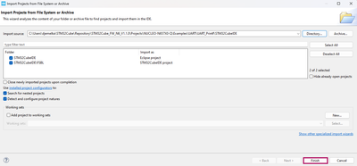

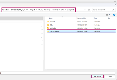

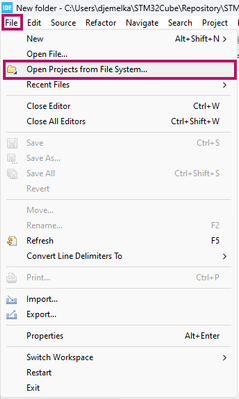

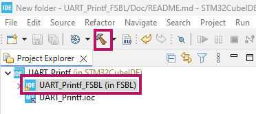

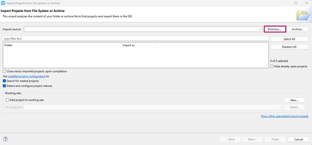

2- Open the UART_Printf using STM32CubeIDE as shown in the below figures:
5-
3- Build the project: make sure that the the build finished without error

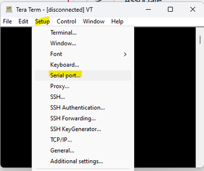

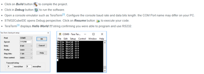

5- Open tera term and change the settings
6- click on resume to execute code and to see the message in tera term

Please make sure that:

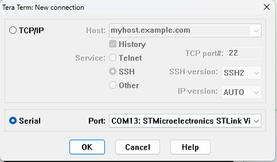

- You choose the adequate serial port as shown in the below figure:

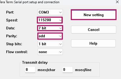

- The HyperTerminal is configured with the correct value
For UART_Printf Example the HyperTerminal configuration (as mentioned in the readme) is:
For UART_Console Example the HyperTerminal configuration (as mentioned in the readme) is:
5-
