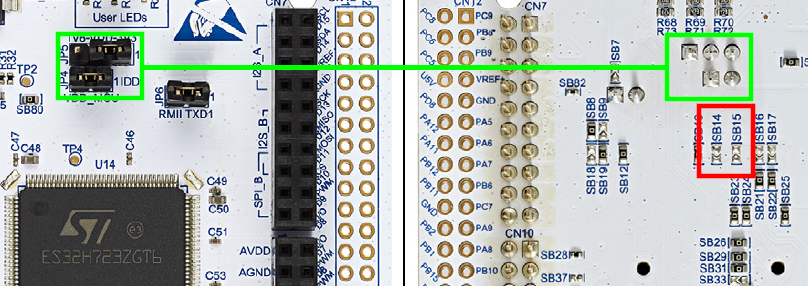

If you look at the schematics of the NUCLEO-H743ZI2, you will notice that pins CN12.1 and CN12.2 are not connected, because SB14 and SB15 are marked DNF = Do Not Fit. Maybe it is some mistake in UM2407, as it mentions them in table 14 Default=ON (closed), but according to the schematics it should be read as Default=OFF.
Of course you can close them, they are located at the bottom layer, almost exactly in the middle between CN11.16 and CN12.16 (red shaped, green for orientation):

Besides listing the wrong default value, UM2407 does not even mention in any way that these two solder bridges are related to PC8 and PC9. It just refers to them as SDMMC_D0 and SDMMC_D1, which makes it quite difficult to figure out what is wrong when you are specifically searching for PC8 and PC9.
In any case, your answer cleared things up, thank you!
