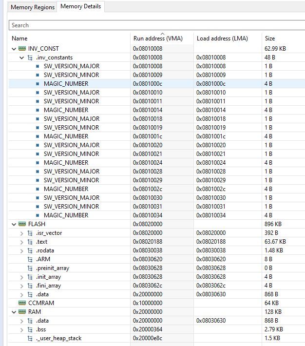

:1000000000000220B1DA0208F9CE020807CF020888This can be better seen in STM32CubeIDE's build analyzer:
I guess the reduplication of the variables in flash is due to padding, but for me it doesn't make sense.
The toolchain I'm using is GNU-Tools for STM32, version 7-2018-q2-update and I'm compiling/linking with g++ (C++ project).
Now comes the problem:
The previous projects were C projects and the same code resulted in 4 times reduplication (now 6 times) of the variables (actually constants) in the custom flash section (by the way, the other variables are placed in flash only once). Thus, the addresses where the other program looks for the constants in flash are no longer valid...
So, my question is, how can I influence the number of reduplication (at best, turn it off)?
Also, if anybody could help me understand why there is this reduplication, I would highly appreciate it (in case of padding I wouldn't understand why there is exactly 6 times reduplication here and why also the longest variable)...

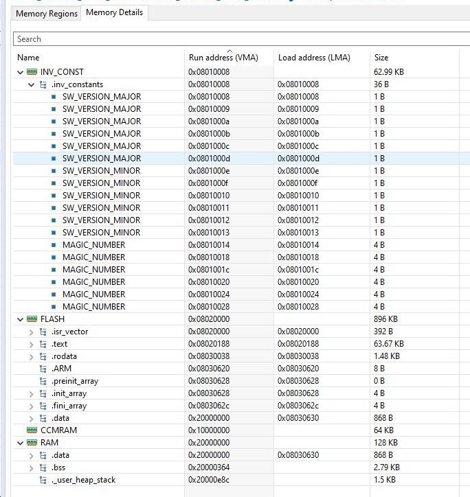

One thing that I already found out is the following:
When declaring the constants in the following way:
__attribute__((section(".inv_constants")))then the whole pack of constants is reduplicated:
So, I can use this to have a workaround:
