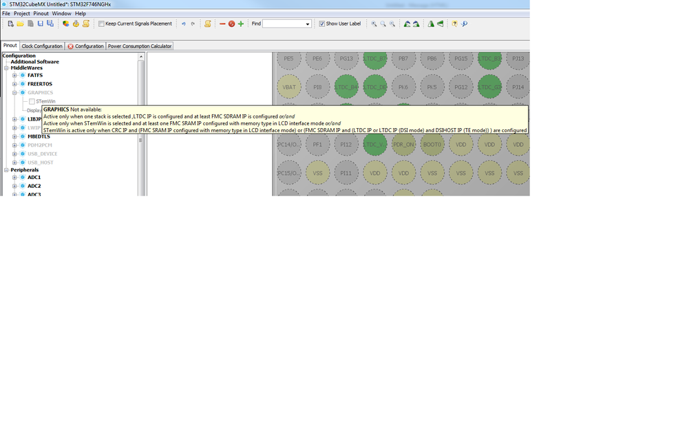

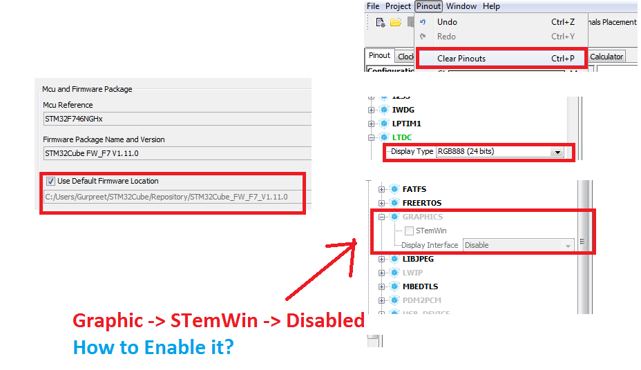

2018-08-17 7:14 AM
Imen ..
I am trying to use STemWin with STMCube . But doing below steps .
Still Graphic is disabled . How to enable it ? What I am missing ?
Karan123

2018-09-03 1:52 AM
Hello @Community member ,
To enable the Graphic and active STemWin on STM32CubeMx, you should follow the instruction in the warning: active CRC and FMC..
