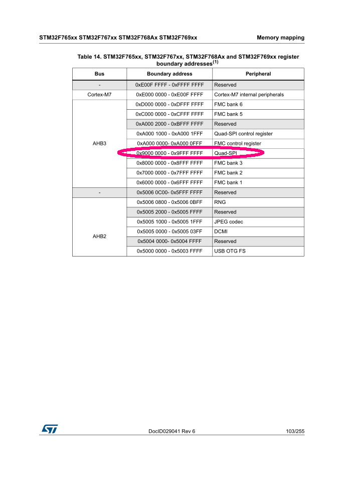

I didn't find it (directly) in RM either - the screenshot is from the DS...
Jan
2018-03-11 5:33 PM
Yes I've now found some examples using address
0x90000000, and even found the following in the stm32f765xx.h device file
♯ define QSPI_BASE 0x90000000U /*!< Base address of : QSPI memories accessible over AXI */
However, there is no mention of this address in the reference manual RM04010 document.That manual does have the 'Table 1. STM32F76xxx and STM32F77xxx register boundary addresses', but that table, in that particular document, excludes the QSPI_BASE address. Obviously an omission on ST's part as some other reference manuals for other devices do include it.
But now looking at the datasheet, which usually is not very detailed, again, I do see the above Table 14.So problem, solved.Thanks folks.
