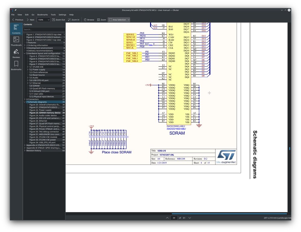

2022-03-03 10:00 AM
Yes, there is really a SDRAM with 256Mbit mounted. Have I noticed this yesterday.
The reason why I have thought that on the board is a 512Mbit (IS42S32160D-6BL) SDRAM mounted is, that I first investigated the schematic diagrams of the board in the user manual. Once again I have looked in the schematics today, there are two types (256Mbit and a 512Mbit) for the SDRAM (U7) noted. I have misinterpreted that, because there is no additional note, which type (IS42S32800G-6BLI or IS42S32160D-6BL) is really mounted.
Sorry, it was a mistake from me.
I have attached a screenshot from the user-manual with the schematic section from the SDRAM.
2022-03-03 10:06 AM
There should be a BOM in a separate file.
This type of part usage tends to allow more flexibility in the build options, depending on costs and part availability.
