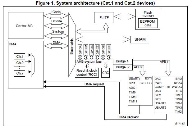

2018-10-23 7:28 AM
There is typical a Clock Tree diagram, a diagram of which TIM/peripherals are on which bus, and the RCC_APBxENR registers also infer which TIM is on each bus based on which bus clock that needs to be enabled.

2018-10-23 8:06 AM
Arbitrary timer A... WHERE is diagram showing which peripheral is on which clock tree?
I just found the timer clock sources in tabular form in the datasheet (not in reference manual where I searched).
Next stop - is a #define for the timer clock frequency output by the CubeMX tool for each timer?

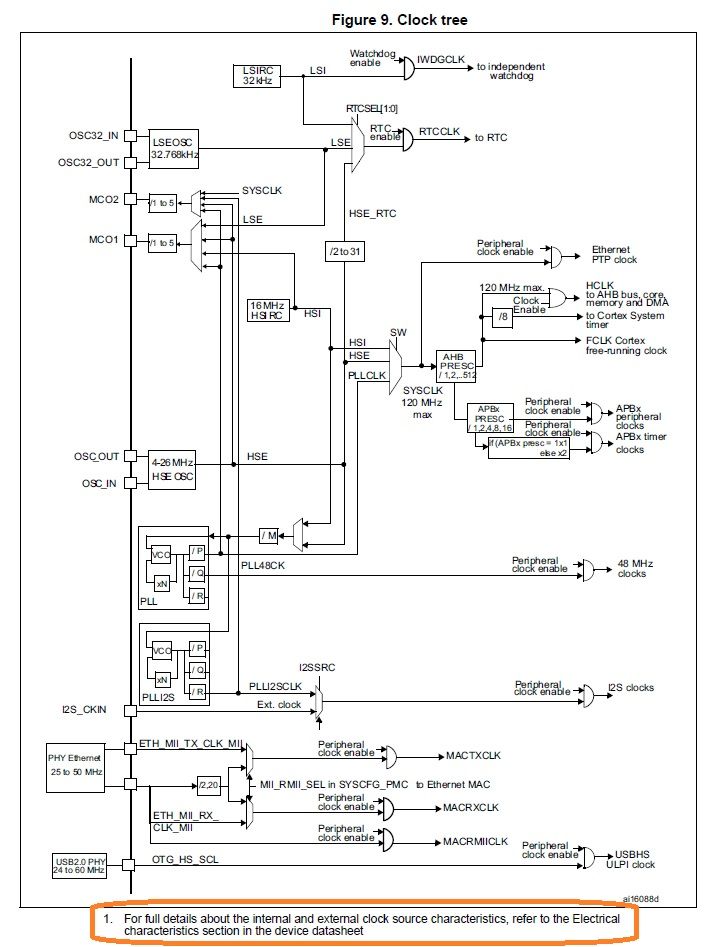

2018-10-23 8:27 AM
ST likes diagrams for the kidz that can't read good and stuff, here from a Reference Manual for an arbitrary STM32 part.

2018-10-23 8:36 AM
Yup, missed that bit in the Device Overview block diagram...

2018-10-23 9:26 AM
CubeMX can show the clocks tree very nicely, if you use it.

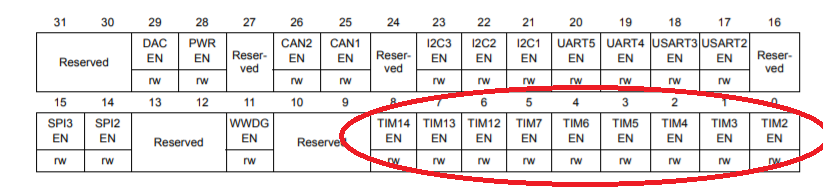

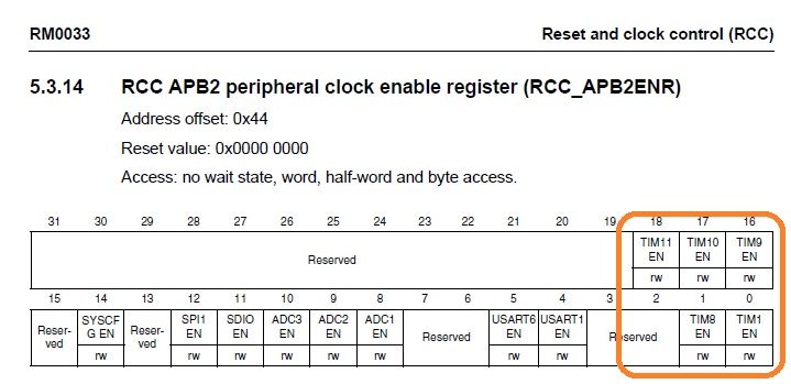

2018-10-23 9:37 AM
Hi @Dave Nadler ,
You may have a look on "RCC_APB1ENR" and "RCC_APB2ENR" registers in the reference manual.
Example: "RCC_APB1ENR " register shows the peripherals connected to the APB1 bus (screenshot taken from STM32F2 RM).
Khouloud.
