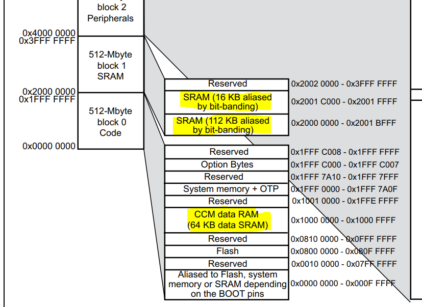

CCM memory is not being used for anything, From the ref manual : CCM (core coupled memory) mapped at address 0x1000 0000. There is 64k of it. That is below the above RAM so clearly not used. But the 32F4 data sheet says "Up to 192+4 Kbytes of SRAM including 64-Kbyte of CCM (core coupled memory) data RAM" so maybe the CCM is the upper 64k? In which case some remapping must be going on. Or maybe the 192k is not contiguous; you just get 128k and the 64k CCM memory is elsewhere.
2021-05-11 7:44 AM
See the reference manual for the memory mapping. In this case:
The memory at 0x20000000 is SRAM and is 128 kB long. The length is incorrect in your linker file and if you try to use more than 128kB your program won't work.
The CCMRAM is at 0x10000000 and is 64kB long. This is not in your linker file, but you can add it. It is not remapped anywhere.
It's common to put the stack at the end of SRAM. You can move it to the end of CCMRAM if you want for a small performance increase and potential pitfalls (DMA can't access CCMRAM).
0x60000000 is in FMC, but since the length is 0, it can't be used in your linker. You could delete it without issue.

Thanks for an excellent reply. I have documented what I have as follows:
MEMORY MAP
FLASH (rx) : ORIGIN = 0x08000000, LENGTH = 1024K
RAM (xrw) : ORIGIN = 0x20000000, LENGTH = 192K BUT only 128k is contiguous
MEMORY_B1 (rx) : ORIGIN = 0x60000000, LENGTH = 0K - unknown
CCM MEMORY (xrw): ORIGIN = 0x10000000, LENGTH - 64k - not used
The 192k is a mistake in the linker file; it should read 128k.
The CCM memory should be used for the stack (enables code to run while DMA is running) but there is a gotcha: DMA and probably other peripherals can’t access it.
_estack = 0x20020000; /* end of 128K RAM on AHB bus*/
Currently we are not using DMA, but will be. And the STM ethernet library uses DMA but AIUI uses its own dedicated DMA controller, so it is a question of whether that library is using DMA to transfer to some buffer on the stack. Hmmm =)
I still have no idea what MEMORY_B1 is.
