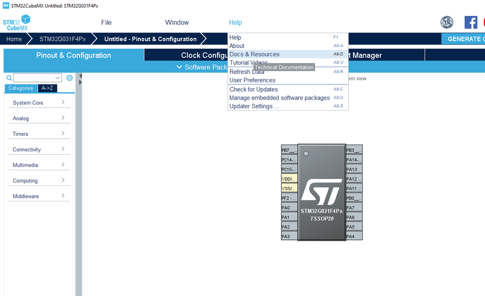

How did i knew whch reference manual was it?
I opened a new progect with cubeMx and went to help/docs and resources( ref manual

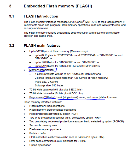

2022-11-03 7:09 AM
Here can find some information about FLASH map memory of G0 family
