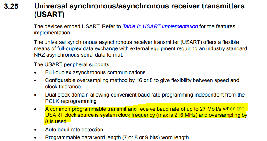

Hi @bengisu taşkın ,
It should not be a problem, the STM32F7 supports a baud rate up to 27 Mbit/s when the USART clock source is system clock frequency (max is 216 MHz) and oversampling by 8 is used.
Increasing your system clock frequency should solve your issue.
Please refer to the attached datasheet Section : " 3.25 Universal synchronous/asynchronous receiver transmitters (USART)" for more details.
Best Regards,
A.MVE
