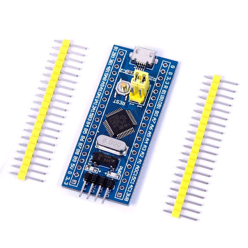

2018-04-05 12:06 AM
I have a similar problem. My project also has the generic startup file. When I searched for the startup file startup_stm32f103x8 in the Firmware folder, it had the startup for every other controller in the series, (stm32f103x6, xb, xc, xg) but not my x8.
I have downloaded the firmware just yesterday but it still doesn't have provisions for my controller. I am thinking of hitting the STM32F103C8 board so had on the wall that it breaks into 103 pieces.
Damn you ST and AC6!!
When you have been shipping the C8 chips for some 10 years, why not take 10 minutes to make its startup file and include in the Firmware???
