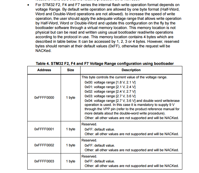

You may refer to the
(page 29) for more clarification.Thanks
Imen
2017-05-08 7:56 AM
Thnaks for the answer.
However the phrase 'device feature set' is no mentioned in section 3.4 'Bootloader Memory management' . I proposed to add the phrase 'device feature set' somehow in that section.
