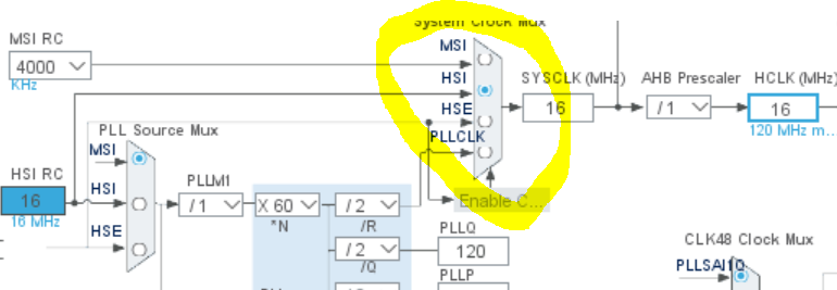

I am working with the STM32L4R5ZI. By default, it will uses MSI as the system clock source at 4Mhz.
My question is: what will happen if I turn on HSI or/and HSE without turning the other clock source off?
Thank you in advance?

Setting HSION bit in RCC_CR register only turns on that oscillator, but doesn't select it as a system clock. The same is true for other oscillators. System clock is selected with RCC_CFGR register SW bits and You can't select multiple sources there.

You'll have multiple clocks ticking, one of which you are clocking the rest of the part with.

Turning on/off oscillators and selecting system clock are two different and to some extent unrelated things. But of course the oscillator, selected as a system clock at that particular moment, must be on.

Sorry, my question was unclear. Yes, I was asking what happen when more than 2 clock sources are selected, what is the SYSCLK will be eventually?
Say that I set the HSION = 1 in RCC->CR to select HSI as my desired clock source, but forgot to turn off MSION in my code(which is selected as default).
Hope that is more clear.
2019-09-08 7:32 PM
The mux can select only one source. You can have other clocks running.
