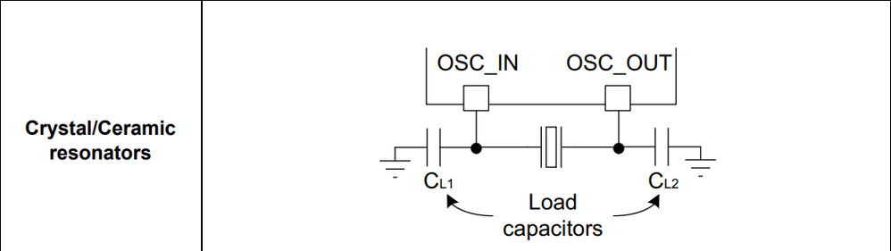

If I use 4MHz Crystal instead of 24MHz Crystal, what will be the value of CL1 and CL2 capacitor?
2023-06-10 12:36 AM
see ds of your crystal.
if you dont have any info about your crystal, take 2 cer.caps , 16p ...22p and test it.
