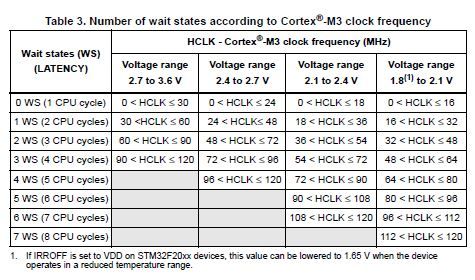

I added capture Table3. Number of wait sate...
It's difference Voltage range...
Thank you!
2023-07-18 7:55 AM
> If i set 7WS, i can use any VDD value?
Yes.
