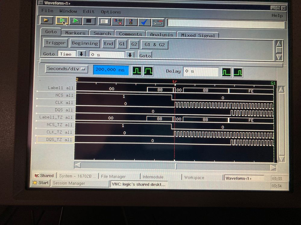

The writing functions seems to work properly, but the reading functions is blocking the program like it was waiting for a data to come but I don't understand why because the memory drives RWDS. With a logic analyser I obtain that frame:
2021-07-16 7:23 AM
The OCTOSPI driver on my nucleoboard is limited to 64 MHz. Is it a problem?
2021-07-16 10:36 AM
Not sure but possibly adjusting some of the timing parameters might help. If not then I don't have any other ideas than to try to get some help from Cypress and/or ST.
