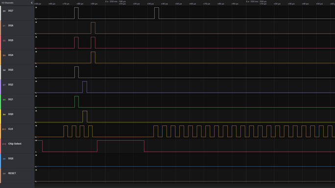

But all that happens is the following:
In the first phase you see the transmit happening. But then after the receive command the controller just endlessly runs the clock because there is no response from the Hyperflash.
What am I doing wrong?

Hello Kaouthar,
in the picture from my post I use 3 MHz for the clock. I decreased it also to around 375 kHz but nothing changed. I don't think that the clock is the problem.
The GPIO speed is set to "very high" for all the OCTOSPI pins...

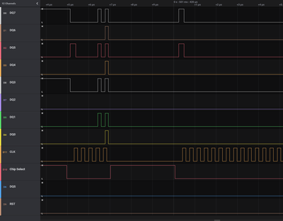

2024-12-02 1:00 AM - edited 2024-12-02 1:00 AM
I also tried to remove the OCTOSPI-Module and just use bare GPIO-commands periodically.

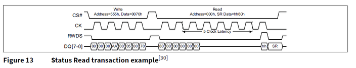

I copied the following "Read Status Register" command example from the datasheet of the S26KL128
But the result didn't change...
Nothing happens after the Read instruction.
Note that after the first three clock cycles of the Read instruction, I configured the DQ0-7 and DQS pins ans GPIO inputs to make sure, that the hyperflash can drive them.
2024-12-16 5:58 AM
Hello @J_Kirsch
The S26KL128 HyperFlash memory requires issuing specific commands before initiating the program and erase command sequence. Additionally, an erase operation must be issued before initiating the programming process. For more details, please refer to section '6.2.3.1 Word Programming' in the memory datasheet. This post may also be helpful: How to Program Simple Data to OctoSPI External Flash.
To read the status, you first need to issue the Status Register Read command by sending the 70h command to address 555h. You then perform a read operation to retrieve the data stored in the Status Register.
Regarding the "AccessTimeCycle" parameter, please note that it should be set to 16 clock cycles instead of 12, according to the memory datasheet (default value).
