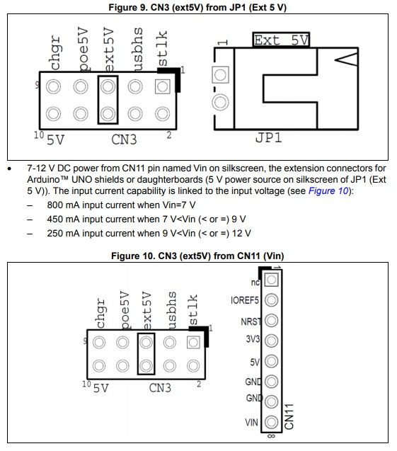

First use USB connected to the Stlink as power input. Care for the correct jumper setting.

There isn't a magic cable/wire
You could perhaps review the schematic to understand all the possible options and injection points.
