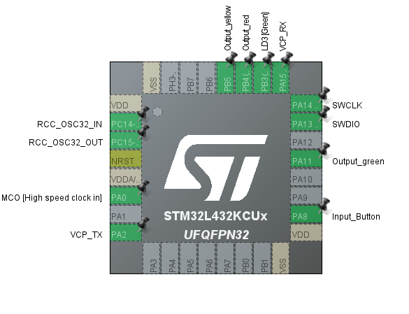

I`m using the STM32-L432KC and the pin setup is as follows.
