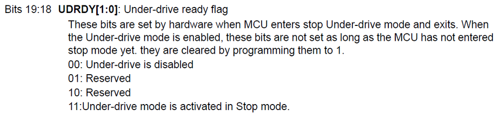

It looks like UDRDY bits get set only when the CPU enters stop mode. You can check for and clear them after it wakes back up.
Sorry. I overlooked this information. Thanks a lot ! :)
