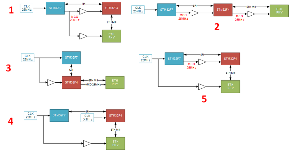

I have a SMT32F7 for control one STM32F4 for comms (ETH MII) and the ETH PHY and I was thinking either one of these (Inclining for number 3):
But I'm not an expert and would like to know what is the most reliable of these:
Or should I use 3 different clocks?
Thank for your help.

What nature is the CLK 25MHz? Crystal or oscillator?
If oscillator, a solution no. 6 when all devices are supplied from the oscillator - most stable and least jitter.
If crystal, I'd prefer no. 2 - the F4 can stop or restart the PHY. Anyway, if precise clock fails, ETH won't work too reliably.

If CLK 25MHZ is a TCXO, option 6, buffer the same clock into all three.
Do you want to control the clocks going into the STM32F4 and ETHPHY? ie turn on/off, low power

That's great! Both agree on number 6 independently.
That's the way I'll go.
Thanks so much for your help.

Hi Edison, Is an oscillator (MEMS probably, still working on the design)
Thanks for your reply. Do you think I need 2 or 3 buffers for splitting the clock for your solution?
