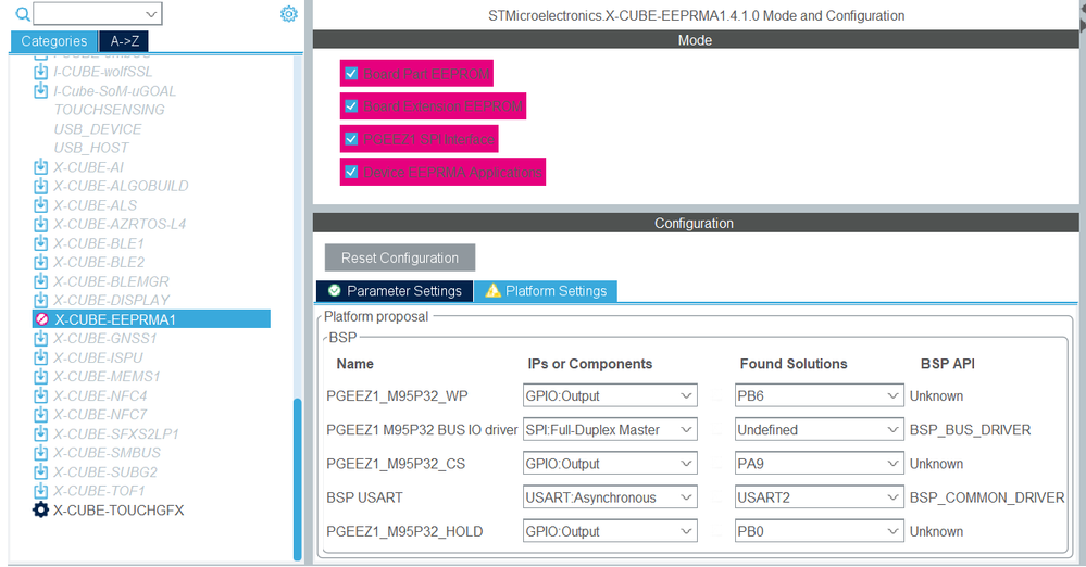

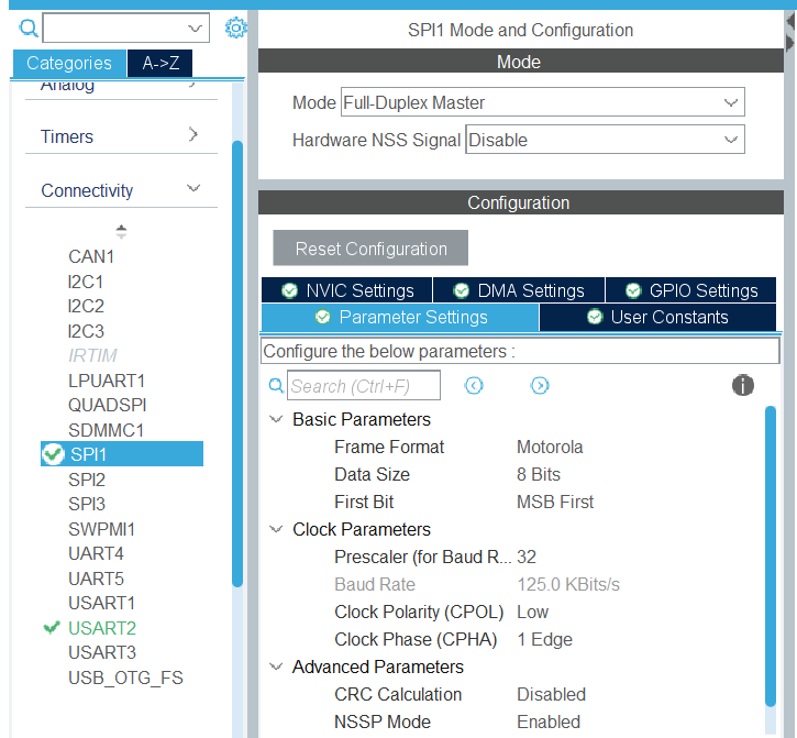

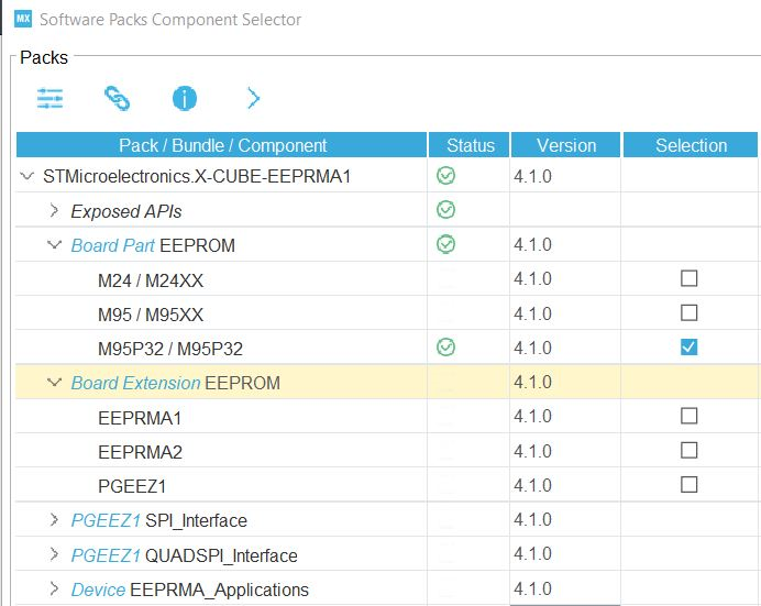

So, going further, let me explain, what problems happen, when you are going to focus on L476 board.
There are two scenarios (with connected X-NUCLEO_PGEEZ1 to NUCLEO L476):
and now - after setting the SPI2 and GPIO's, it everything looks linke that:
So -there is no way to use PGEEZ1 in proper way.

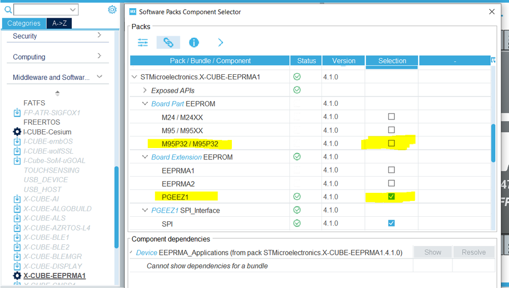

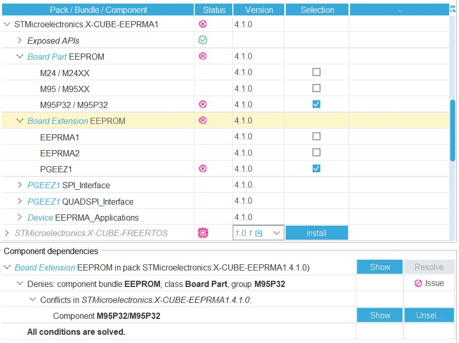

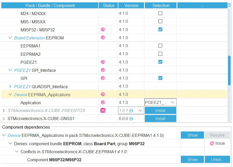

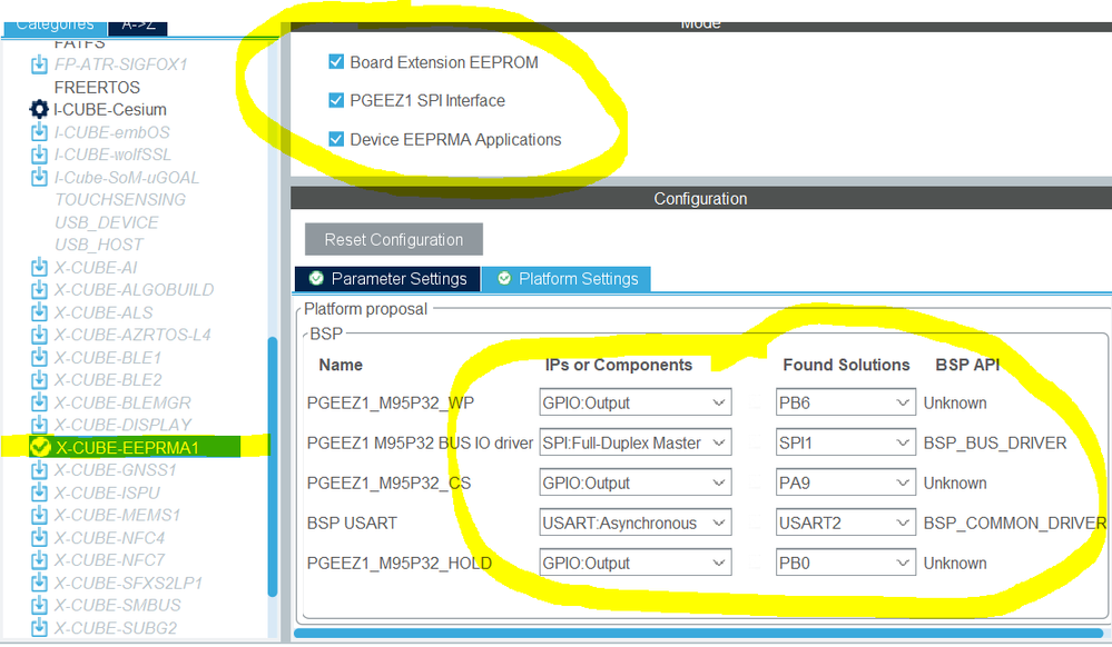

.2. And now second aproach. First - after chosing the microcontroller L476 (not Nucleo, because in Nucleo we have PA5 GPIO acting as a LED, on F401 is also LED connected to PA1, but the github example runs correctly) board and initalising everything, we don't go directly to X-CUBE-EEPREMA1 in Cube, but first - we set up SPI and GPIO's:
than we go to X-CUBE_EEPREMA1 and we see, that also this time nothing can be configured, there are still errors.:
but if we will unmark Board Part EEPROM--> MP95P32/MP95P32 option, and mark only Board Extension EEPRM--> PGEEZ1 option, we will see green signs, that everything is ok:
so we might think, that probably everything should go right, after cofiguring nessesary things in PGEEZ1:

2023-05-22 8:54 AM
2023-05-23 1:21 AM
Your answer solved the problem. I must admitt, everything I did before, was almost right. I didn't put the PA5 to reset state (first mistake), and the settings of PA9, PB0 and PB6 was a little bit different (3rd column, there was Low instead of High). And the "GPIO OUTPUT LEVEL" column was the cause of problems, after changing it to "Low" - the project doesn't run poperly. When I change that parameter to HIGH, everything is fine.
Also, another lesson to learn, thank you for helping me and hope, next user with the same problem will read this thread and use the info.
