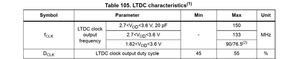

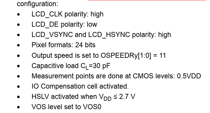

2023-03-04 9:20 AM
from ds :
2023-03-05 6:32 AM
OK, I understand that according to the datasheet the maximum pixel clock speed is 150 MHz in those conditions. But I understand that's the maximum speed that the LTDC controller can handle. Then I guess the actual speed will depend partly on the SDRAM and bandwidth, but that would be another question. So I could say that the initial question is answered, but that leaves me with other questions. Anyway thanks for your answers.
