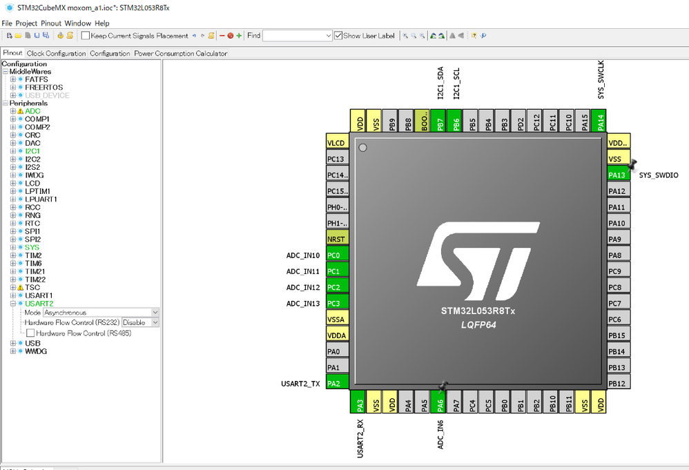

I use CubeMX and I use PA2 and PA3 for the UART2. When I enable UART2 on the CubeMX, PA2 and PA3 will be the port. No choice. But there is another alies UART2 port on PA13 and PA14. PA13 and PA14 is connected as SWD port on the Nucleo bord.

I use PA2 and PA3. The color is green that mean OK I think.
