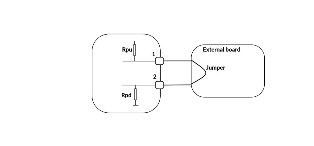

Imagin the next sequence using two GPIOs. 1 will be receiving interrupts and 2 just as an output.
State 0 - Jumper disconnected
Pin 1: Pulled up
Pin 2: "0"
State 1 - Connecting the jumper
Pin 1: Pulled up. Falling edge interrupt.
Pin 2: "0"
State 2 - Connected
Pin 1: "0". Pulled up so there is consumption. Rpu can be disabled by software to avoid it.
Pin 2: "0"
State 3 - Jumper disconnected
Pin 1: No pull up so, How to detect a Rising edge as a disconnection event?
Pin 2: "0"
