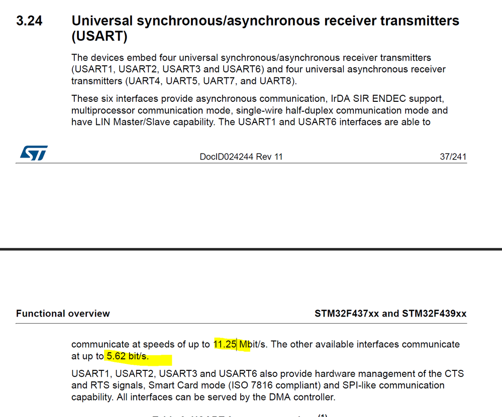

I am using 115200 bits/s for now and was wondering if I can increase that. If yes, how much can I go until? I checked the datasheet for this board and nothing was mentioned about the baud rate.

Easily several Mbps
Limits tend to be APB / 16 or APB / 8 depending on the Over Sampling settings. I suspect you're just looking in the wrong place.

That really helped, thank you!
It's in there the datasheet for the chip.
