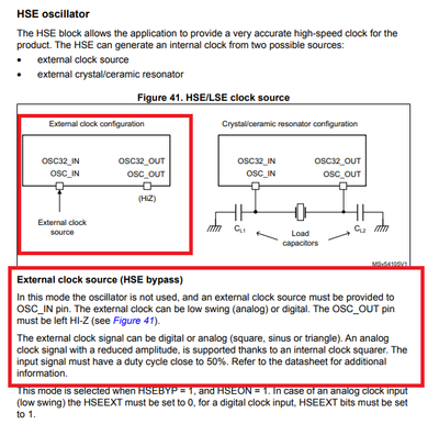

Hello @mƎALLEm ,
Thanks for the updates.
What is Bypass mode? Can you please provide guidance for this?
Thanks & Regards,
Jignesh Karena
2025-09-08 12:11 AM - edited 2025-09-08 12:18 AM
For such questiion you need to refer to the reference manual of the product: RM0477:
You need to use OSC_IN only. The crystal oscillator output connected to OSC_IN.
If you are using CubeMx, this is the configuration:
Hope it's clear now.
