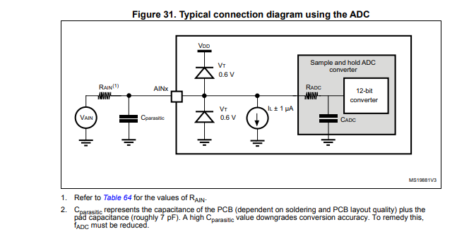

most users first look in ds and rm :
0693W00000aHaHGQA0.png0693W00000aHaHzQAK.png+ if you see a buffer here, you know... Is there internal buffering?
