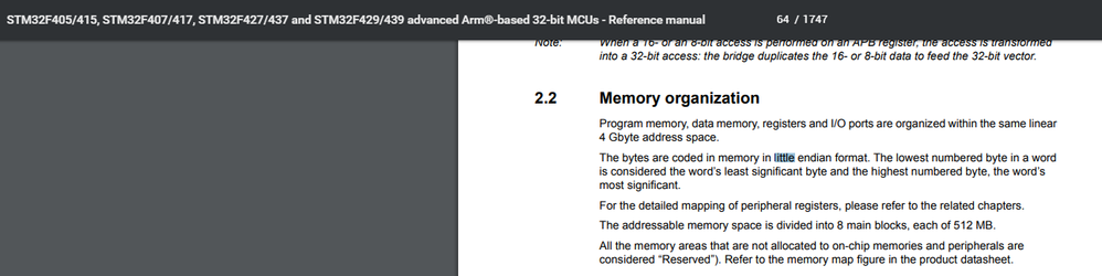

I checked the data sheet of STM32F407 and it says it is little endian.

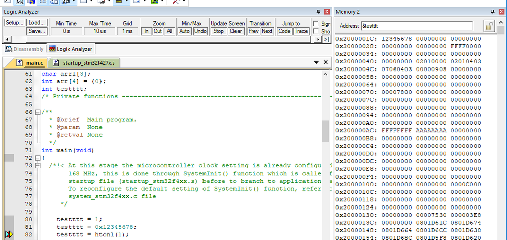

However, when I test in a real device in MDK, it shows that it is big endian. I assign an int "testttt" as 0x12345678. Then, in memory window, it shows as 0x12345678 which is big endian.
Is there anything I missed?

I think you missed the point that the processor doesn't perceive the numbers as being backward, you write 0x12345678, the processor and debugger see it as a 32-bit word 0x12345678.
Want to see it in byte order? Then select the debugger memory view to show BYTES rather than WORDS.

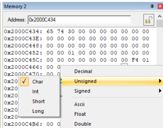

Just find that MDK memory view can display such many options: char, int, short, long, even float and double. Cool!!!
