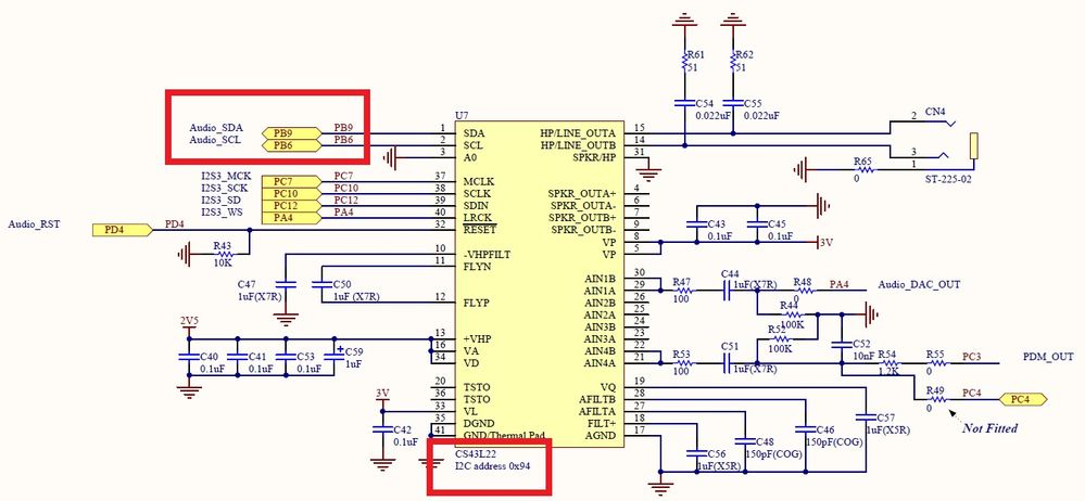

I want to interconnect STM32F407 microcontroller (on the STM32F4 Discovery board) with CS43L22 audio DAC from the same board and external TV tuner R820T but on the same I2C bus. The R820T works correct when RESET line of the CS43L22 is tied low. When I turned RESET line to high in my code and added initialization code for CS43L22 (including I2S) it works fine but R820T not. Here comes schematic diagram. The CS43L22 and obviously R820T are connected to I2C1 PB9 (SDA) and PB6 (SCL):
The A0 line is connected to ground so I2C address is 0x94 and it's correct. According to the R820T datasheet it has 0x34 address:

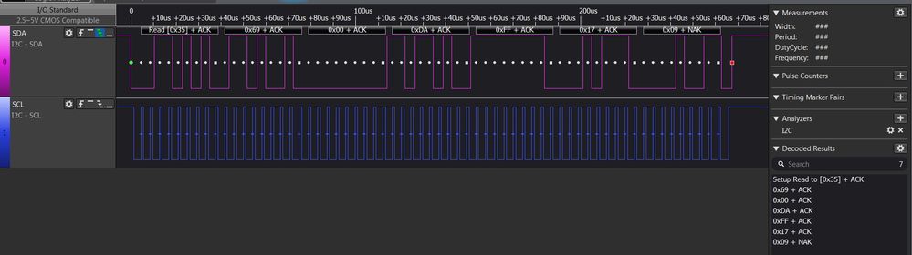

I don't have any I2C devices and It's exactly as I expected. Here comes proper reading sequence of R820T from logic analyzer with CS43L22 RESET line low:

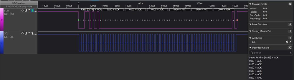

It's everything correct and no addresses conflict. The same experiment but with CS43L22 RESET line high:

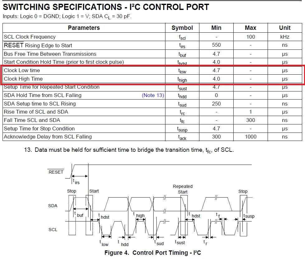

As you can see I got all zeros because CS43L22 tied SDA line to ground. I have large SCL frequency because CS43L22 requires something like that (roughly 115 kHz or higher):

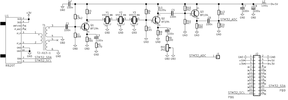

My goal is simple SDR receiver based on the R820T. I designed simple analog IF amplifier and I estimated calculation time in STM32F407. It should be possible to do that. Here comes IF schematic diagram:

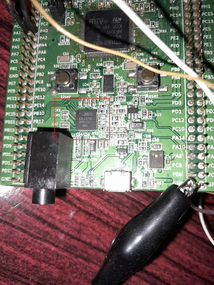

@AScha.3I took photo of the CS43L22 on my Discovery Board:
I can cut path from AD0 and solder it via piece of wire to +3V but I don't want to rework on the PCB. It's obvious that it change 0x4A address but I don't know what would happen with secondary address 0x1A that is the same like R820T address.
2025-05-31 4:12 AM
So try it - then you know. :)
IF your CS43L22 has a problem with its address decoder, it should change to 0x36 .

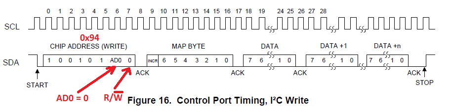

It's not like that. I checked everything with logic analyzer and oscilloscope and it's obvious that CS43L22 respond to both addresses and it's everything explained in my first post. I connected R820 to other I2C bus.
The datasheet address 0x94 from CS43L22's datasheet's is left shifted. It means that I have to use 0x94 with HAL drivers just like that:
#define DAC_I2C_ADDR 0x94
static void write_register(uint8_t reg, uint8_t *data)
iData[0] = reg;
iData[1] = data[0];
if (HAL_I2C_Master_Transmit(&i2cx, DAC_I2C_ADDR, iData, 2, 100) != HAL_OK)
CS43_TIMEOUT_UserCallback();

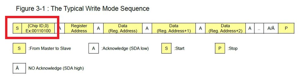

}Here comes write sequence from datasheet:
Generally speaking it's one of the most strange hardware issues I've ever faced.
