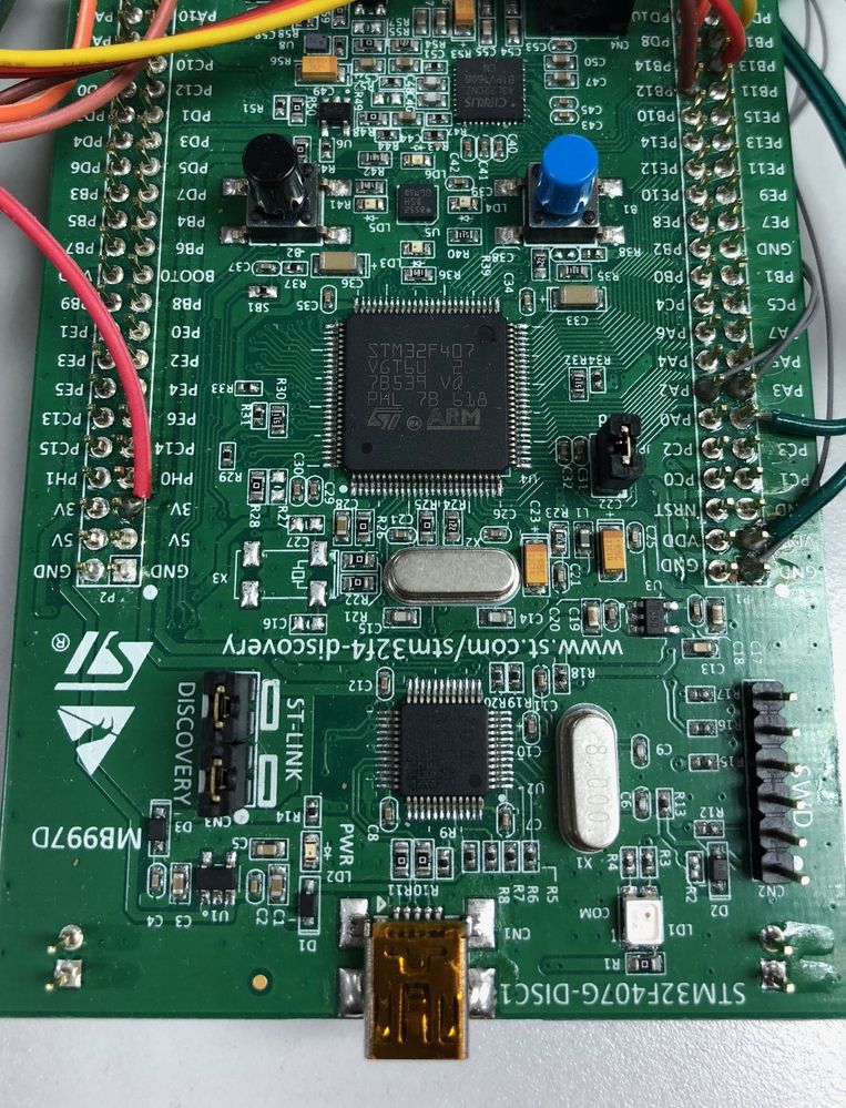

Strange it occurs on a Disco board. Is this a genuine DISCO or some copy? Can you please post a photo of it?
2018-06-15 5:52 AM
It is just a normal STM32F407 Discovery Board that bought from the ST website. Please see the picture.

Perhaps a shelf hugger re-usage ?
2018-06-18 3:17 AM
Interesting.
There should be no functional differences to STM32F407VGT6, once erased.
