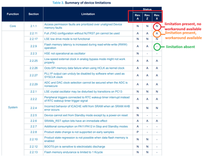

2025-05-13 10:08 AM
The differences are listed in the errata itself / especially Table 3. Summary of device limitations:
You need to contact your supplier about the revision available before purchasing the parts.
