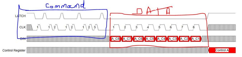

I am currently using a driver that uses latch and clock signals to send special commands before sending data.
For the sending of the data the driver works as for an SPI but with the signal of clock.
Here is the diagram.
To interact with this driver I am currently using the microcontroller pins in GPIO out and I generate the output signals without using the SPI device.
The problem is that by doing this I block my application while if I used the device SPI I could do something else in parallel.
Because if I want to use my SPI port I will have to whenever I want to sent the start of the special command reconfigure the pins out and once the special command sent reconfigure the device SPI.
Is there a way to manage this kind of communication?
Thanks in advance !

2018-04-24 12:55 PM
Hello and thank you for your answer dhenry.
I do not really understand the difference between your two proposals but I know that I can use the interrupts to manage this
What I would like to know is if between the COMMAND part and the DATA part I have to change the alternate function of the pin.
In part command I have to be in GPIO out configuration to send different clock and latch spikes and then reconfigure my pin for SPI function ?
