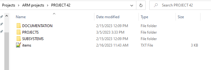

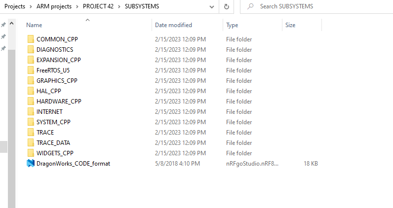

The basic project structure (modified from the default) is to add SUBSYSTEMS, which is a file structure that has all of the common files. It does not include any unique files per project. Each file in SUBSYSTEMS is common to all projects.
Now the overall directory structure is
and the project directory is
and just for fun, the common files are:
Now, there's no reason that you have to follow this setup, but it does work for me.
