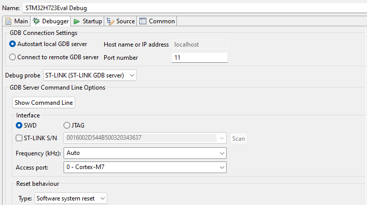

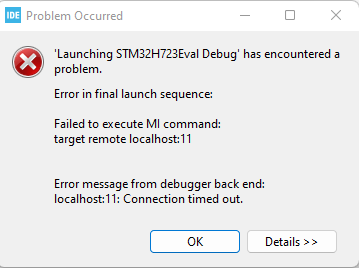

I'm trying to do the same, debug two target boards at the same time when both are running. How to set the debug port number to make it connect to the different board?
When I change debugger configuration by using the port number from Port COM 10 or 11, I'm getting connection error
So far, only use Autostart localhost, by connecting one board at a time works.
Thanks
2023-03-24 6:04 PM
Select ST-LINK S/N with the scanned value can find the right board now.
