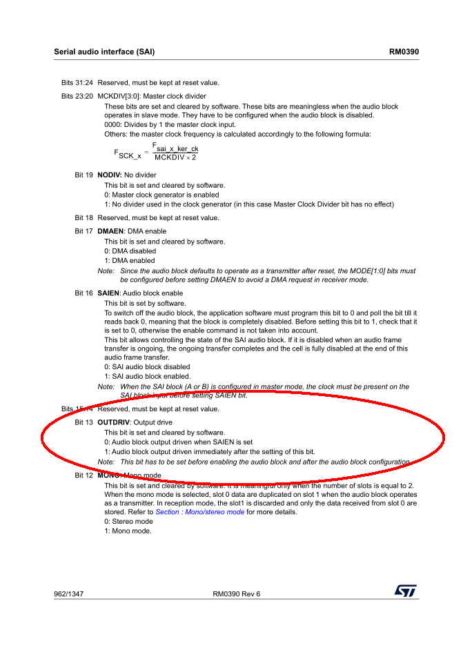

Okay, so it's basically just one bit, SAI_xCR1_OUTDRIV. So now look into the RM:
So this bit determines, that if SAI is set as Master, whether the respective SAIx_SD_x pin should be output all the time (if OUTDRIV = 1), or if it should go to high-impedance state whenever the respective SAIEN = 0 i.e. the given SAI block is disabled.
