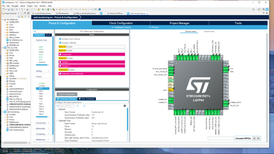

I want to the RTC to my project, but something is preventing the RTC clock from being enabled and I can't figure out what it is. IOC file is attached.

I just created a new project from your .ioc and RTC is enabled !
Please mark as solved if you agree problem is solved.

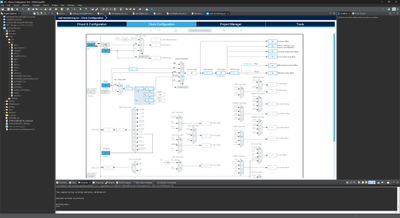

Then why is it grayed out in the Clock Configuration view?

How can I fix my configuration so that the RTC clock is enabled without breaking my project?

Your project opened just fine and I see that the RTC clock appears to be enabled. I still don't see how to fix my project, though. I'll try recreating the configuration, starting with the RTYC clock being enabled, then drop everything else in one item at a time and maybe discover what is conflicting. I might then be able to add my code to the project and see if that works.
