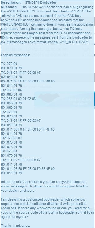

I realized probably I didn't give enough info so my first ticket got rejected. Therefore I initiated another ticket with much more information, hope they can take serious this time. It seems not easy to retrieve the ticket content in text format, so I captured the screen shot and posted below. If anybody read this post and has the hardware and software to repeat my exercise described below, please report your results. Your effort will be highly appreciated.2013-12-05 7:39 AM
