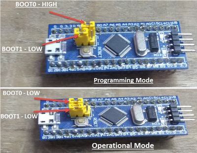

2023-11-14 11:29 PM
I am using stlinkv2 just check the jumper position it will solve the issue
