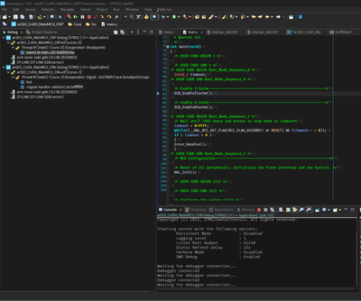

[Updates], I debugged by step my program, M7 only, disabling the M4, and found out that the SMPS that I selected on .oic was wrong, corrected it then the program works now. However, integrating the M4 program still gives an issue "SIGTRAP" as shown on the attached image. I hope someone can help me with this. Thanks

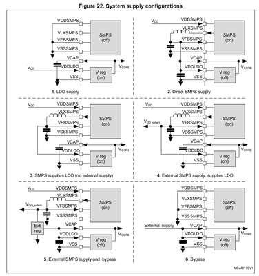

Check your HW and see what is the power supply config your board is mounted to (refer to the Figure 22 in RM0399):
According to your power config in CubeMX it's the 6th config (Bypass config).

2. Yes power supply, my bad, I changed it now, my SMPS is like that of Figure 4. I found out this works now.

Moving forward, my next goal is to get the M4 core to work with the correct power configuration. However, I get an error right after the HAL_Delay inside the while loop. This breaks the loop. May I ask what caused this error, see image.

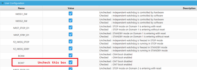

Move your system clock config from M4 side (for example blinking a LED) and disable M7 from option bytes using CubeProgrammer (BE SURE YOU DON'T ALSO DISABLE CM4 CORE)

I did what you suggested, moved my simple toggle code to the M4 core, disabled hardware semaphore and other unnecessary lines leaving only the GPIO initialization and other stuff generated by the IDE, and then rebuilt it.

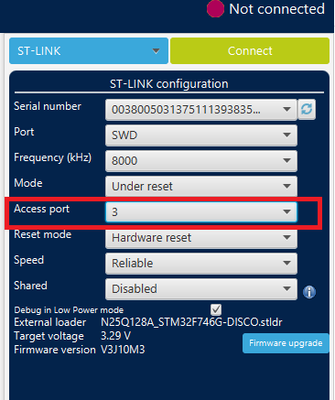

However, my problem is that when I unchecked the BCM7, and applied it on my board using the cubeprogrammer, the chip broke. Now I cannot even connect with my cubeprogrammer. I tried to pull up to boot0 to VDD, but it says it cannot reset the chip. then I pulled up the RST too, but still, I could not connect.
How sad I cannot verify this on my other board coz that too I bricked it. :( Is there any other way to revive the chip?

You need to connect with Access port 3 in CubeProgrammer (as shown below) as CM7 has been disabled (Access Port 0)
