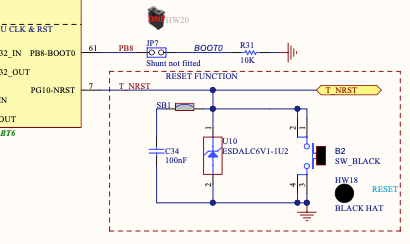

2024-01-26 7:22 AM
Thanks for your reply.
To test this I created an empty project based on Nucleo-G431RB board and ran it on a Nucleo board and it works perfectly. But when run on my own board the exact same project hangs on any call to HAL_Delay()
So something in my design is not letting the system timer run. Hmmm.
I've attached my schematic.
2024-01-26 7:49 AM
Check your BOOT pin. It's floating.
Check the application note AN5093 Getting started with STM32G4 series hardware development boards / Figure 8
2024-01-26 8:04 AM
Thank you again,
Yes, I considered the boot0 pin - but it is also floating in the NUCLEO board
Plus, the code does start and run. Just the system timer is not running.

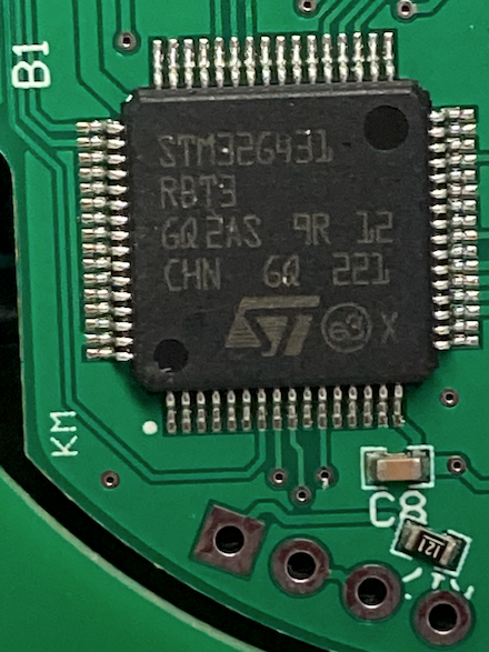

I'm beginning to suspect faulty or damaged chips. They were assembled by a reputable PCB firm in China.
I'm very careful with ESD using an ESD mat on the workbench, and proper ESD wrist straps etc.
I think I will transplant the STM32 from the nucleo board onto my board and see if the problem persists or goes away.
2024-01-26 9:44 AM
So I have 10 of these prototype boards, and so I pulled out a brand new one, programmed it with the project and it worked... kindof.
If I start the project with the dbugger attached using the RUN button then it works fine. All the timers and UART etc are doing there thing.
But if I disconnect the programmer and reboot - it hangs at the first call to HAL_Delay. So something is causing the system timer not to start. I cannot find out what it is. I've checked all the VSS and VDD pins, all are good, VDD is 3.3 V and nice and clean. Reset signal is present and correct. If I manually reset (by taking NRST pin to gnd,) I get the same symptoms. I tried adding __enable_irq() but it made no difference at all. The chip looks genuine.
2024-01-26 10:03 AM - edited 2024-01-26 10:04 AM
How are you determining this exactly without a debugger attached?
Feels like a floating BOOT0 pin would explain the general behavior.
2024-01-26 10:09 AM
I'm observing the output of PWM on TIM 1 CH1 using an oscilloscope.
Yes maybe, but the NUCLEO boards do have this pin floating. Also, if BOOT0 was to blame, it would be booting from SRAM which would not run Main and I wouldn't see my PWM on the oscilloscpe.
However, to be sure I will tie the BOOT0 pin to GND and see what happens.
2024-01-26 10:15 AM
In most STM32 BOOT0 is it's own pin, here it shares functionality with PB8
Check that their aren't Option Byte settings to perform an equivalent function, ie boot into user flash by default.
