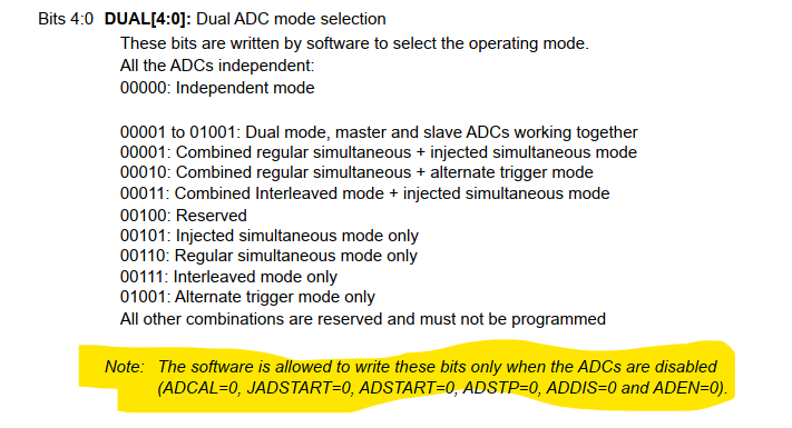

2021-07-19 8:08 PM
I found that one mistake is done. I have enabled both the ADCs and then dual-mode selection done but it violates the process recommended by ST as below screenshot. What could be the consequence of it?
