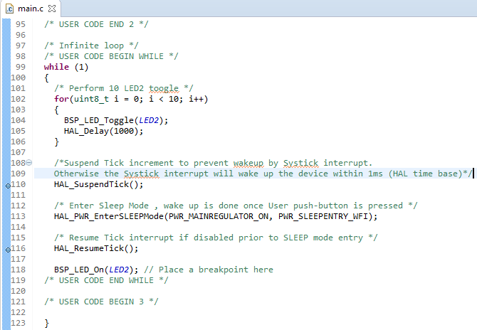

2017-05-29 3:46 AM
Hello Albert,
I took a little time and tried the basic code of Sleep Mode on a board NucleoF446 (because I do not have an L15x).
I have all implemented with the latest version of SW4STM32 v2.0.0.
I did not have any problems with the debug as you can see in the code below. It works fine.
I placed two breakpoint, one at line 110 and the next line 116.
After LED2 toggle loop, and first breakpoint. the core enter in sleep mode. The last breakpoint is reached when PC13 - USER Button is pressed. And theLED toogle restart.
Let me know if you have any issues.

Hello Romain,
Thanks for sticking with me.
I have used another board (STM32F4-Discovery) that I had and generated the code with CUBEMX.
I did run the test and it behaves as it should with debugger attached breakpoints and all.
