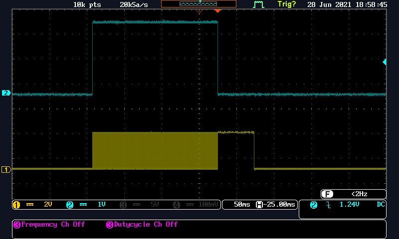

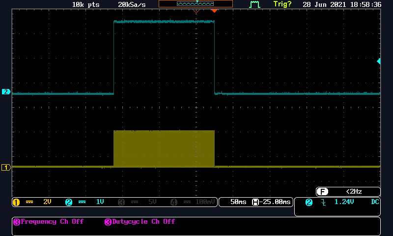

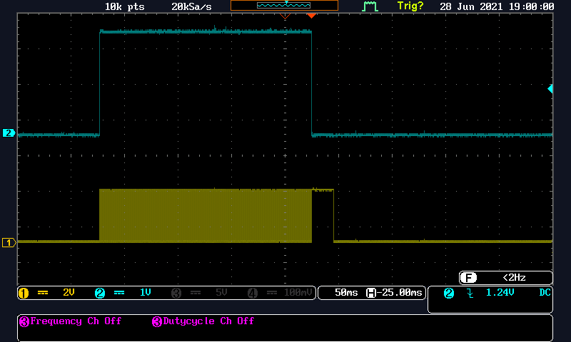

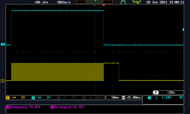

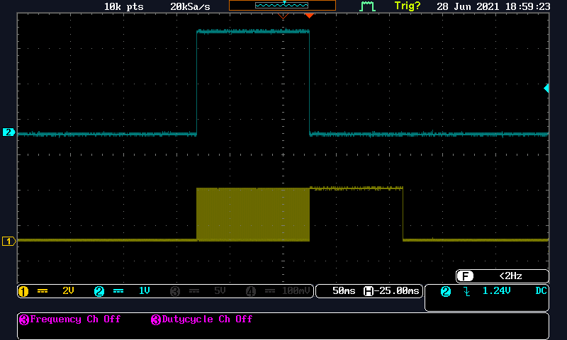

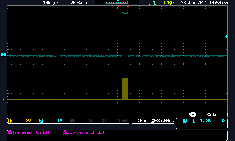

Hello, I have a timer 3 master and timer 1 slave. When a button is pressed, master is activated as long as button is pressed, and then slave is triggered based on master's output signal (high / low) (gated slave control)
This is a continuation of my previous post here -> https://community.st.com/s/feed/0D53W00000uWUzeSAG
Correct outputs (below)
Wrong outputs (below)

Hello, sorry for not clarifying the question at the start. My question is to why there is a portion of the slave output being held high when the master is already low level?
I would like to set it low during falling edge interrupt, but how to do that? Do i need to use forced timer output?
