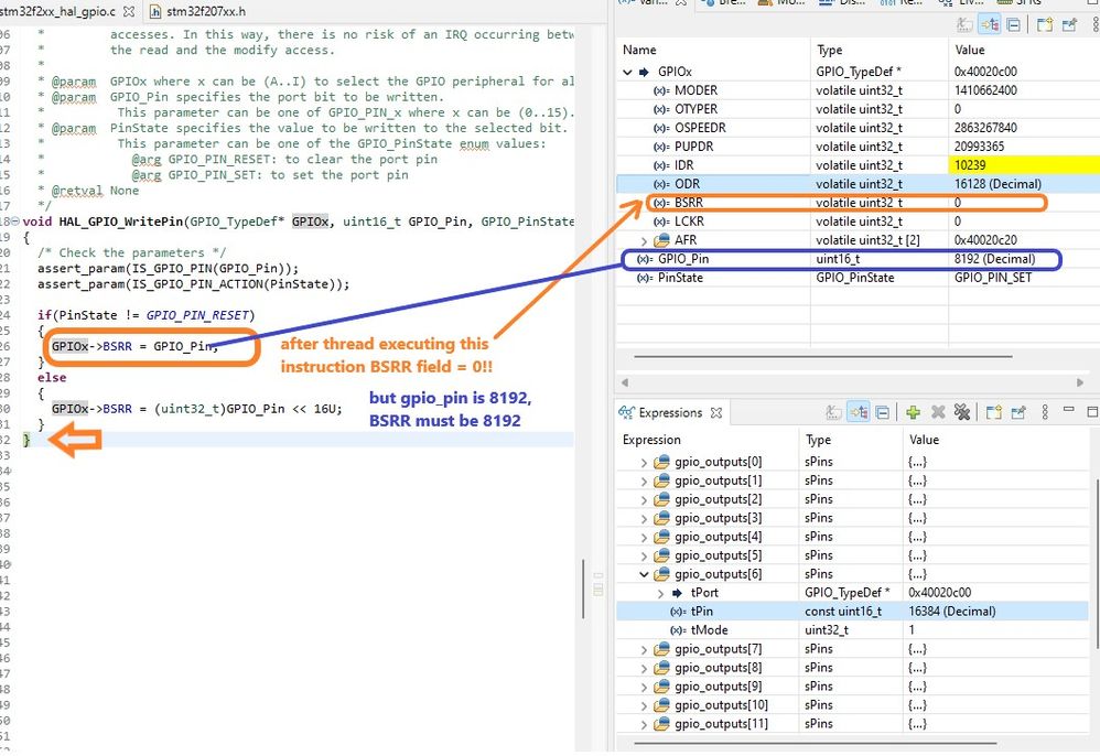

And I found this situation even when output pin is being updated correctly with "high" level:
I can't see any value at BSRR field even after being updated. Despite of this, writing '1' is working for this GPIO_pin writing.

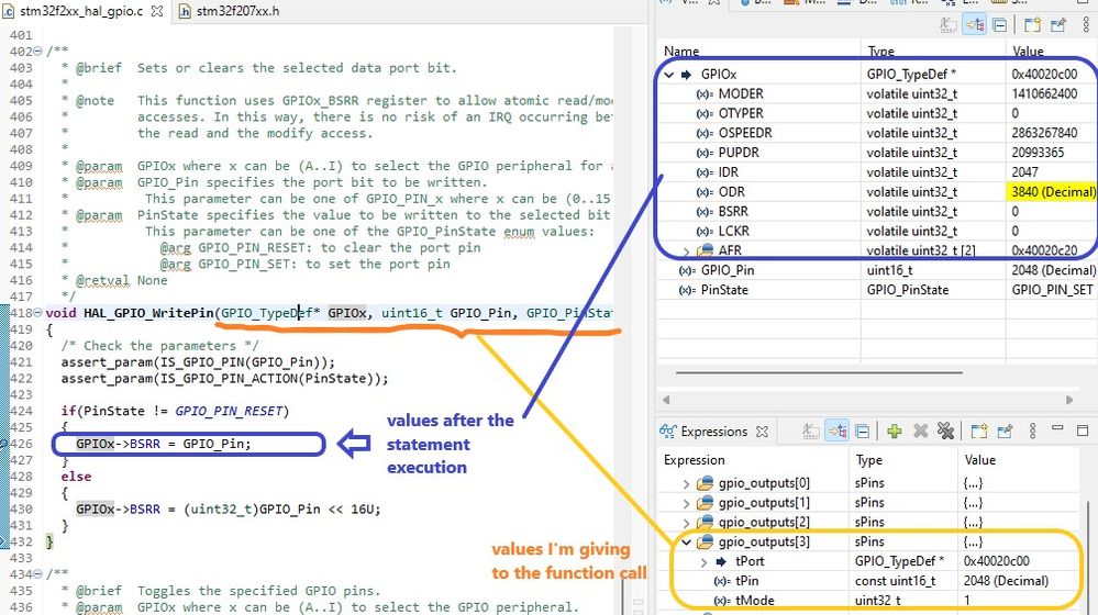

When watching the same window after the same thread actions for a set pin failure this can be seen:
I'm unable to apreciate too much differences between previous image and that one.
Does anyone see any relevant value that could explain why after the statement execution microcontroller is unable to put 3.3V on this pin?

Please set your debugger to display in hexadecimal. Decimal display of registers is mostly useless.
Storing 2048=0x0800 into BSRR means that you are trying to set pin 11 of given port, and indeed, ODR=0x0F00 which means pin 11 is set. However, you've set MODER to 0x54150000, which means that pin 11 is set to 0b00 = Input.
2023-02-28 5:18 AM
BSRR is write-only. So the value the debugger is displaying is irrelevant. IDR shows the pin state as measured by the input part of the GPIO.
hth
KnarfB
2023-02-28 6:47 AM

It would be a sign of overwriting the pin mode field of those pins at some point of the code, after being them initialized.
But I have just checked this issue and you are right. The content of the MODER register is configuring the two pins that dosn't work correctly after initialization.
I have found that I was overwriting this register bits in other part of the code, after output initialization.
