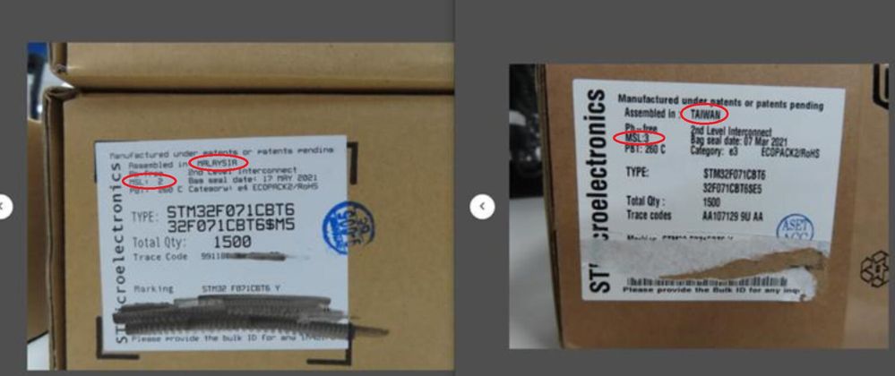

2021-07-14 6:29 PM
Hello Imen, thanks for your kind reply.
Please pay attention on the uploaded label photo of STM32F071CBT6 , the left one assembled in Malaysia marked MSL 2, but the right one assembled in Taiwan marked MSL 3. My question is that is it different coo with different standard on the MSL ? Or any other reason ? Are they functionally equivalent ?

2021-07-15 7:05 AM
Typically have slightly different materials (plastics, chemistry, descants) and packaging (equipment, methods, process) at every location, should follow the label.
Look also to be e3 and e4 parts, that relates to the lead frame metalization as I recall.
Apart from baking, might want to watch the soldering too.

2021-07-16 9:06 AM
No, that's why it says Community Member
In a normal world your supply chain would get you boxes of parts from the same production facility in a single delivery.
The fully qualified part types here are different, if your database can't handle two different handling procedures for the base part number depending on the type/source of material, perhaps you can use that.
In previous posts related to MSL ST has indicated you need to follow the LABEL designation and the materials and facilities have different and non-identical situations.
@Imen DAHMEN perhaps a more visible document indicating expectations from different facilities, and plating types, would be helpful in the near term given that people are likely to be sourcing parts from all manner of suppliers and distributors currently.
2021-07-22 5:34 AM
Hello @KChen.9 , @Community member ,
Sorry for the delayed reply on this, I was in long public holidays.
I confirm that they are equivalent functional.
But Not the same Bill of material for LQFP package:
@Community member , I escalated your request to involved people to add more visibilitybin the document.
Imen
